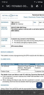

Looks like this is what we have been waiting for... my truck is going in next Thursday. Just thought I'd let everyone know that's sick of their RHO pulling to the right!

My dealer said my truck got an update while in the shop that may fix the highway steering drift. Picking the truck up tonight & I’ll report back if it was the same TSB & if the issue is gone.

Yup! Did 50+ miles of highway yesterday.
Got the flash & it works…kinda. Not an immediately apparent change, but…
Highway drift still follows the road grade, but it’s better….maybe 50% better? Now, if I let the truck drift, it goes 50% further before I have to correct the path. The road grade compensation of the EPS still doesn’t work as well as it did on my ‘15 Ram, but it’s getting there.
Hands-free cruise…90% improvement…no more “ping pong” between the lane lines, but it still hugs the left line around left curves in the highway. Frankly, I couldn’t use the feature before the flash update…it made my passengers motion sick. Used it probably 1/2 my trip yesterday & no complaints.

After tsb I still feel like I get a little drift with crown, but less... and steering definitely feels lighter

No, dealer has to do it. Takes about 2 minutes for the flash to update EPS.
