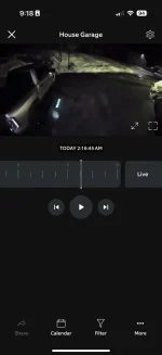

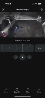

Not sure what happened on mine. Might have been over the air update, app trying to talk to truck triggered something but in the end what I could see was the Ram puddle light turned on by itself around 10pm one night and stayed on until 2am killing both batteries. Since I saw this the next day on my ring camera I have no idea if anything else was on inside the truck. See the time stamps on the pictures. I was shocked I could charge them after going so low but maybe it only being like that for 6 hours helped. Other than that one time my truck has been perfect.
