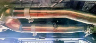

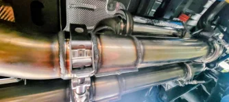

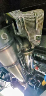

You can see the ones from MagnaFlow in the box (left side) also are spring operated, although I'm not sure if the spring tension is the same as OEM.....I didn't install them though, as noted above.

These are the SPEQ resonators that I have installed with my MF Xmod -- see images above for the delete and instruction paperwork
