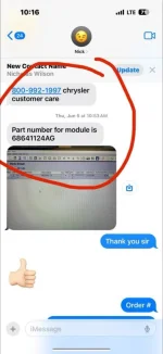

Ohh damn you got a lot here’s the Ram Care number just incase dealer tell yall the part on back order and your vehicle end up in the dealer for months

If y’all still have yall truck in your possession try this see for this loose connection
I called all they said was I have no recalls available haha sounds like there needs to be one to adress these electrical issues to many people have them
