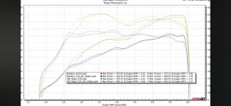

@JLM1600 and JB industries both tried the same part # and removed immediately because of loss of power. Not sure how better numbers are being attained. Smaller air intakes definitely make more noise.Someone pointed out the K&N opening doesnt match up exactly with the factory Ram CAI box opening. I still wonder how much of this sound is air passing through where it shouldn’t be, or being overly restricted by the smaller filter.
I really can’t explain it, but also see others showing it’s measurably slower with K&N so there are conflicting reports. I’d even read K&N says this kit isn’t specific to the RHO, so I’m trying to confirm fitment.How do you explain the increase in performance then?
They say that the K&N made more boost but less horsepower and torque. It didn’t even make sense to them how it was making less power with higher boost. More boost creates more heat, more heat = less power. If the intercooler was designed for 28psi boost, it is likely not cooling adequately.I really can’t explain it, but also see others showing it’s measurably slower with K&N so there are conflicting reports. I’d even read K&N says this kit isn’t specific to the RHO, so I’m trying to confirm fitment.
Jeff is saying he loves it and that’s awesome. I’m really just trying to understand where the additional noise is coming from and whether this kit has any detrimental effects to a RHO.
Hot air is less dense than cool air. If the air being fed into the engine is too hot, it can reduce the amount of oxygen available for combustion, even with increased boost pressure.
During the JB4 dyno runs, the hood was up for all pulls.I was hoping JB4 would publish the IATs when going to the K&N. My guess is the IATs increased compared to the stock box due to not aligning and mating to the ram air system. Thus hot air under the hood infiltrates, raises IATs resulting in less power. That is the only thing that makes sense. Perhaps in the test Jeff posted, IATs were not as bad as JB4s dyno runs.
It would be some work but very helpful to publish IATs with the OEM Intake vs K&N.
