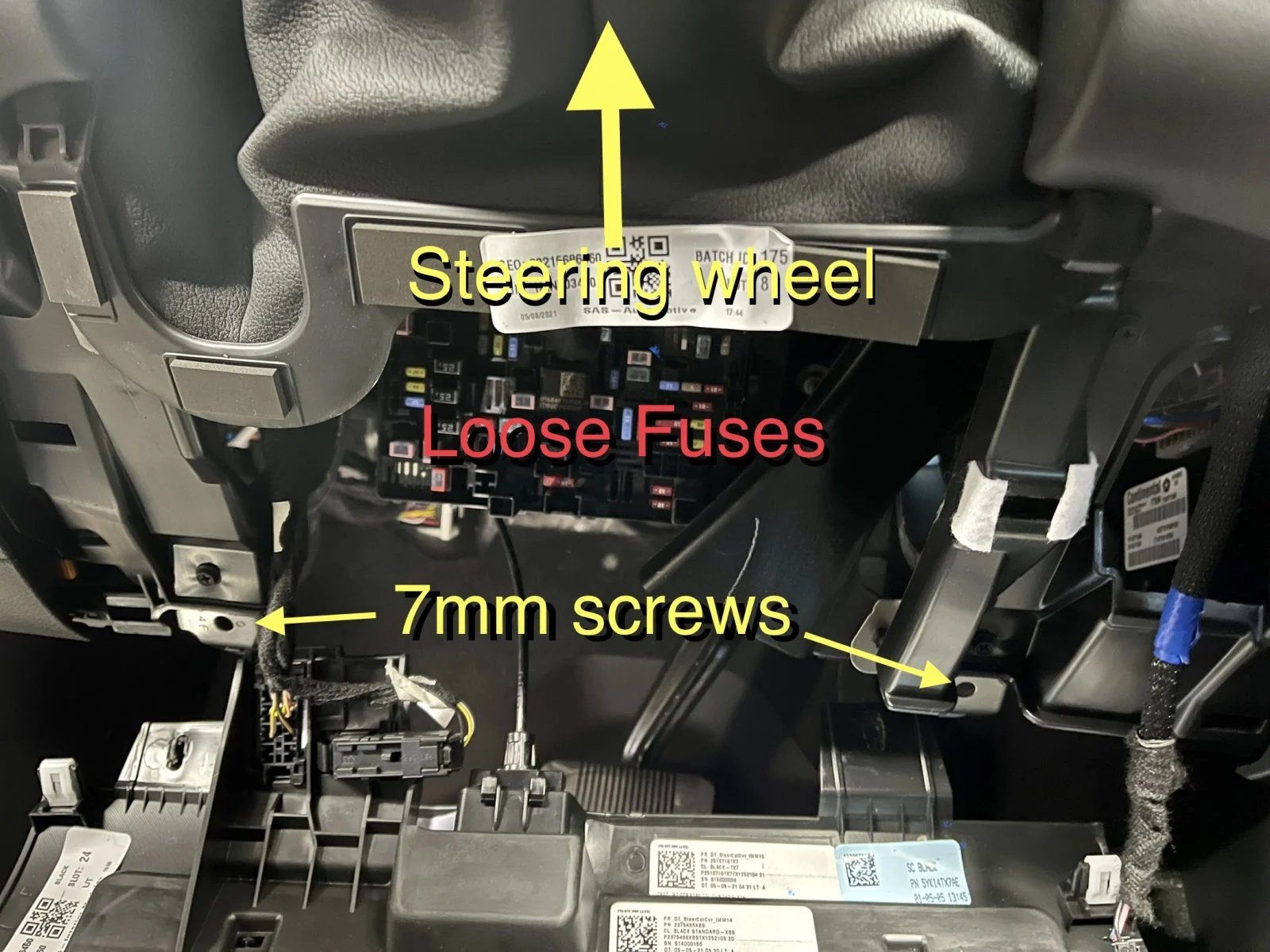

Also check the ones under the steering column
I checked the under hood box…everything tight. Haven’t checked the one under the dash yet.

The errors went away after a couple of restarts and have not come back. This was before I seated all the fuses. My interior fuse block was fine.
