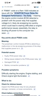

Got this code today and rho had a dead battery. Jumped it, check engine light came on with this code logged by jb4
Note: jb4 tuner installed last week. Gonna have it removed and see what happens. Then to dealership i guess.

P068A means the ECU lost power. His truck had a dead battery. The ECU slolwy losing voltage would be able to register a supply voltage loss because it has internal capacitors & store it in the EEPROM (Non Volatile Memory - NVM)
There is nothing wrong with his truck - his battery died.
Why his battery died? - may be related to his aftermarket components or he left a light on.
I would not take it to the dealer - I would just drive it.

I'm having the JB4 removed. Not taking any chances. Had no issues for 3 months, had the JB4 installed and 3 days later, i come out from work, my battery is dead, i charged it, checked the code and it was the P068A. Not sure why the battery was dead, or why if anything would of been left on. I do know that i've never had an issue before the JB4. Now it could have absolutely nothing to do with, but i don't like to take chances...plus removing it if and when i have to go to a dealership because this happens again, kinda a pain. Def was a spur of the moment purchase, but not worth it until i see how the truck continues to run or if i need a new battery. I'll put a few more thousand miles on it, allow others to add the JB4 and see how that goes, and maybe i'll try again one day...just don't need the headache at the moment.
If it drives okay without poor performance or ruff running I would do that first. While the JB4 should not record any excessive boost it very possibly will have suspicious looking trim values stored. If you can drive them out I would. However do not do it if it is not running fine. If it runs bad bite the bullet and have it towed in

Got that code when I first installed the DiabloSport. I cleared it and knock on wood, it hasn’t come back.
According to DiabloSport that error occurs often when you disconnect the battery(which you have to do installing this). It usually takes a few drive cycles to clear it but with the app I have, I was able to clear the code and didnt wait.
