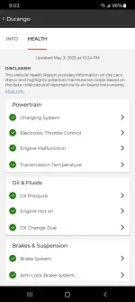

I feel for you, brother. Two weeks ago, I decided to bail on my RHO order for these EXACT concerns. I got a leftover 2024 Durango Hellcat Plus for $30K under MSRP. My biggest problem is dizziness when I launch it hard. It comes out of the hole like it's been fired from a cannon. 1300 miles in, here's my health report.
