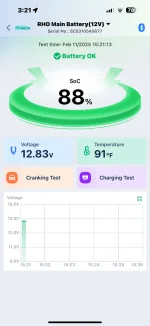

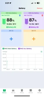

I bought (2) of these units and its really nice to monitor by just opening an app on cell phone. I like the SOC (state of charge), voltage and temp. Can monitor 4 batteries all at once.
That is clever and looks like your batteries are heading to the mystical land of warranty replacent, assuming the app is as accurate as multimeter. My main holds 14.5-14.75 and Aux is 13.1-13.6.
Have you tested its accuracy against multimeter? If it's accurate I'm all about it.

Funny thing. These are both replacement batteries. I also did what you did. I put my fob and key card in a faraday box. I can charge the battery and I will still loose overnight.
The app is following along with a volt meter. I kept both OEM batteries maybe I should try the recondition with my NOCO charger.

You made me just go check. The app voltage and Klein multimeter reports back the exact same voltage. I dont know WTF is eating voltage overnight. I have deleted the RAM app, put fob in faraday box, and turned off proximity on the Uconnect. What else is left? I also tried the battery long term storage. While it didn’t loose near as much in that mode its kinda a PITA, you have to unlock the doors with the actual key to get back in.
