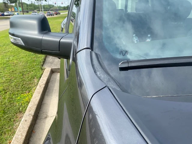

I noticed this and was wondering if anyone else has this issue. Maybe not an issue yall tell me. Drivers side seems off compared to passenger side on the quarter panel and hood. Am I too picky or should this be fixed?

Mine is off there, the hood to fender, and the fender A-Pillar. Both the gap getting wider and the hood being sunken below the line of the fender. Plus, my tailgate is pushed to the passenger side and just kisses the bed side at the top when opening & closing. This seems to be a trend as far as the tailgate.

Mine had same issue. There is little twist knobs under hood to adjust it.

My hood was below fender as well. The twist knobs under the hood adjusted it.

I have both issues, hood is low and the panel gap from hood to driver side fender grows to 3/8”. I’ll see what the dealer says/does, if they can’t get it right I’ll take a crack at it.

Mine was off on the passenger side. Flame Red too! I adjusted it by loosening the top fender 10mm bolts along including the one under front grill including top headlight bracket. Pushed it in alignment and tightened everything back up and it looks perfect. It's not the hood.
