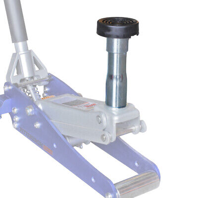

Go ahead and measure the hole diameter of where the jack pad sits, save some $$ and having another floor jack taking up space. Order yourself a floor jack extension. Just verify if your jack saddle is a drop in, screw in/on, or pin mount - they make them for all types. I had to grab one for lifting up my SxS. But like a few others said, lift from the A-arm or axle... and use jack stands.
https://www.amazon.com/Short-Round-Saddle-Extension-Drop/dp/B0CJ3Z46MK?th=1
https://www.jbtools.com/esco-equipm...cT8empem6y_9XHisaiy6QMvZjUZpcRDhoCY_YQAvD_BwE
https://tiresupplynetwork.com/produ...e-floor-jack-extension?variant=39579006533694
