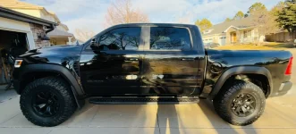

37s, no level, no rubbing, no significant rake.

Zero rubbing. You can feel the extra weight as you would on any truck with larger all terrains. I did the same on my TRX and the RHO feels better.

I know it's a cold day here in CO, but when you have chance, can you post more pics of your vehicle?
Sure. Busy family weekend but I’ll try to take some shots early next week if I can’t tomorrow.

12.5 looks no skinnier than the factory tire (it’s literally a 7mm difference). Neither look skinny at all. 37x12.5 just fills the wheel well. Looks like it should have come this way.
