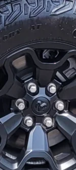

Will these work if you have 1 round LOCK lug?

if the diameter of the wheel lock is a larger diameter than what the opposing "flats" on the hex lug nut is, then no, it will not. I have McGard locks on my '14 sport, and the hex lug nut covers will not fit...but the O.D. of the McGard locking nut is significantly larger than the OEM lug nut.
