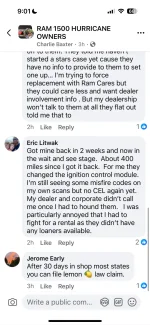

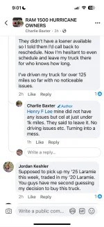

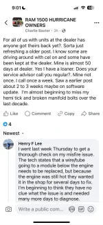

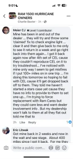

Anthony, are you seeing any issues at your dealership with the 25’s coming in with misfire issues? Any idea how RAM is handling these issues? It’s happening to several folks.
