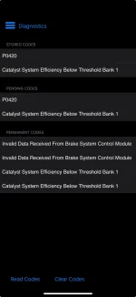

Just over 500 miles and CEL is on, ran code scanner see below.
Any suggestions?

Bone stock? I'd clear the code, pull the negative battery terminal and wait a bit and see if it resets.
Just an update for anyone interested. Took the truck to the dealership for diagnosis, they ran some code update. They said it was good to go, drove it and not even 3 miles down the road the CEL came back on. Turned around and took it right back. They got to it yesterday morning and found the drivers side cat is faulty. New cat is on BO for a couple weeks. Not impressed.
