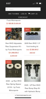

I see Foutz already has parts available for the RHO, duplicates of the TRX upgrades. Has anyone used the front leveling kit in a TRX? With the lighter engine I’m guessing there’s less of a rake, and that’s why the RHO sits higher than the TRX. Just trying to figure out which level kit will actually level the RHO without going to high in the front.

I like rogue’s kit better. Uses spring spacer for 1” - 1.25” of lift , but it comes with an optional tower spacer. Tower spacer is only a quarter inch thick so it does not go beyond the ball joint and CV joint angle tolerance. It gives an additional 1/2” of lift if needed. Too thick of a spring spacer can result in excessive preload giving poor ride quality due to putting the shock piston to far out of intended ride height range depending on internal shock design.
I like rogue’s kit better. Uses spring spacer for 1 1/2” of lift , but it comes with an optional tower spacer. Tower spacer is only a quarter inch thick so it does not go beyond the ball joint and CV joint angle tolerance. It gives an additional half inch of lift if needed..

The front fenders on the TRX are cut higher than the rear. I have seen when you add the leveling kit, it makes the truck appear as if it's squatting in the rear even though it's level—an optical illusion. I would wait till you get the truck to decide.
So which is better and why? Looks like rough country has a kit thats way cheaper than foutz also a few different options on ebay. I couldn't find any info on rogue.

I would go 1.5", well...that's what I'm going with. I think I'm leaning towards Eibach front springs vs Foutz.
