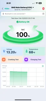

If you put your truck on a battery tender with an amperage meter - how much does it draw when the truck power latches? (goes to sleep) I'll test mine.
I just went and checked again. I know it’s been on for over 4 hours but it’s off now. I dont know if it had something to do with me charging the batteries or not. Once I reached 100% SOC it was off.
I guess now I have a baseline to see what voltage is tomorrow morning.
