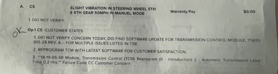

My wife’s Frankenstein had a vibration around 40-50 mph. If I remember correctly they flashed the TCM and it fixed it. I think there is a TSB on it. I will check the service records when I get home.
pretty sure I will be seeing the ballance issue from 65-80mph on the highway. Steering wheel you can see move
Check this out. Also happened in auto with my wife frequently. I haven’t researched the TSB but the TCM update fixed it .
