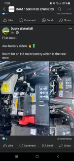

Hey I just saw a post on the FB forum regarding an Aux battery and swapping it over for an H8 main battery?
First - is the guy that posted that on FB on this forum? Dusty Waterfall?
Second - very interested to understand what you intend to do and your reasoning. I'm assuming because clearly the batteries coming from the factory suck balls. 🤷‍♀️
Thank you
Curious myself

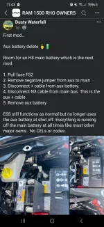

Wonder how he did the delete? In my wrangler you just take out a fuse and can then you can disconnect the battery. As a bonus taking out the fuse kills start stop so one less button to push every time.
You can swap them out. Done it on the last three trucks I’ve owned. It’s the same battery location as the hemi and with the etorque. I probably have around 120k miles between three trucks in the last 4 years and they all get swapped. I plan on doing it to this truck when I get it home next week.
Modifications:
You will lose the little wedge piece that is on the side of the battery because the H8 battery is about 2inches longer maybe at lost(never measured). But it still gets secured in the tray just fine with the hold down bolt and clip on the front of the battery.
FYI: people that still want a battery cover, Ram makes them and you can order them from the dealership or eBay either one.

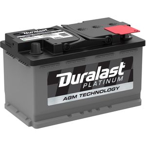

As far as batteries go, there is I think 3 major battery manufactures in the world. So go for the one with the best warranty. Last I checked the Walmart Platinum AGM H8 900CCA batteries still had the 3 year replacement promise. Cost for the battery with core will be about 200 bucks depending on which Walmart you live near. Make sure you look for the battery with the newest (freshest) manufacture date on it.
