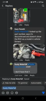

Hey I just saw a post on the FB forum regarding an Aux battery and swapping it over for an H8 main battery?
First - is the guy that posted that on FB on this forum? Dusty Waterfall?
Second - very interested to understand what you intend to do and your reasoning. I'm assuming because clearly the batteries coming from the factory suck balls. 🤷‍♀️
Thank you

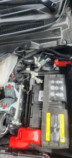

aux batteries suck.... ballz. I'm deep in the Jeeps too and they have doing that since circa 18. They fail every year or every other year and cause a bunch of low voltage and main batter issues. Avoiding all that from the get go plus the OE are having issues with the batteries these trucks come with so that is going straight in the trash. The OE tray will accommodate an H8 battery by simply removing the "7" holder in the tray. There is still room for an aux battery with the H8 if you choose. I really like the idea of more CCA, AH and RC from the larger H8 and eliminating all the current and future issues associated with aux batteries. Something of note the ESS is disabled which is also a bonus to me.

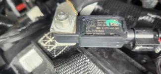

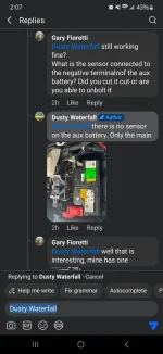

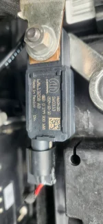

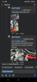

so I happened to reach out to the guy on FB, an interesting situation here...
I asked him what he did with the sensor on the auxiliary battery, apparently he didn't have one, but I do.
Isn’t @DBallz Dusty on FB?
That’s odd you have the aux sensor and he doesn’t? Anybody else? I’m starting to think our trucks are really made in China, lol.

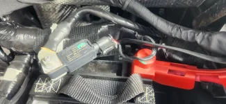

anybody else care to check to see what their truck has? also, whether you had a battery issue or not
I have the sensor on the negative terminal of my Aux battery (as well as the main battery). At 2400 miles, I have not had any problems with my batteries. Mine was built in November.

Had auxiliary battery die, have both sensors. Card is out of truck, keys in Faraday box. I think the hours at tint shop finished off the battery with door open but it was likely just a bad battery.
