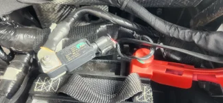

I'm not an expert when it comes to electric, but just going off the of pictures of mine (attached), it appears your main battery sensor is picking up the current going through the aux wiring and the aux wiring sensor isn't picking up any current. You're not running the current through the sensor; the aux sensor is just bolted on essentially. nothing is going across/through the sensor.
Anyone, please feel free to chime in and correct me, I'm all for learning, as this is something I was hoping to do a long while back, but it became a dead issue.

I see what you mean now.. the 1st sensor would actually be reading the current of both cables going through it.. and if the sensor is "polarized" somehow, meaning the input on bottom and output on top, i also have that inverted for the aux battery one.
I'm going to find a terminal that will allow me to attach both independently without going through in series and see if that fixes the issues.

I went back and re-did my AUX removal to fix my previous mistakes.
Seeing as how from everything I found the L2+ trucks don't have a PCR or fuse that can be easily bypassed, I went with my original approach.
I tied both IBS from main and aux - to the negative battery terminal, in my original removal I didn't realize i tied the aux battery - IBS to the main battery IBS output, so the main battery IBS was measuring the current draw of both which is what was probably causing my charging voltage to be 14.8 all the time. This was a mistake on my part. With this new method my charging voltage is 14.4 on startup and then drops to 13.8-13.9.
I then used a 50A fused wire link to jumper N3 (AUX Battery +) to N9 (Main Battery +), and disconnected the original N3 wire that runs to the AUX + and heat shrunk both ends just to keep it clean.
Everything is working as expected, with no OBD codes, and start-stop works also (although I will keep it disabled).
I used this to tie both IBS. https://www.amazon.com/dp/B09W24MCHD?tag=ramrho-20
Until a better, proven method comes out for the L2+ trucks I'll keep using this.
