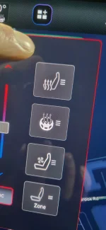

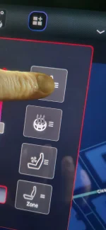

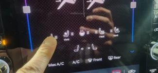

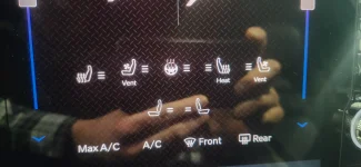

Tried auto comfort with key, off on, key cycles, out of the blue the driver heated seat won't work. Every single either one does, it won't let me turn it on from the connect screen
Any ideas?

Did you pay to extend your heated seats beyond the 30 day trial period? I believe they are subscription based.
Ha! They are not subscription based. Thinking you may need a dealer visit if they stopped working “out of the blue”.
Odd how the seat in the display is sitting a bit low…
When I first started reading ypur response I started believing it haha
Yeah, that's what I'm thinking, just hoping someone else experienced it and had a fix
Also is missing the word “heat” under it (compared to passenger seat) … why it’s sitting low on the display
Wonder what happens if you try a different profile on the uconnect system (like a driver 2 profile)
