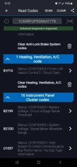

thank you for the heads up, ordered the bluedriver yesterday, at my door at 7am this morning from amazon, only $80 on amazon right now too.
says I have an open circuit on the seat heater. I'll try and see if I can find anything under the seat. Anybody have wiring diagrams for the truck? not even sure what connector I'm looking for.
(ps ignore other codes, all left over from my dead battery issues)

NP. This little device has saved me a few times on other previous vehicles. One in particular was on a diesel Jeep Gladiator. Lighting bolt and check engine light on dash 1.5 hours from home. Something about a turbocharger waste gate and it put the Jeep into limp mode. Was able to clear the code and make it back home.
It will save all scans so you can go back and see everything that has happened on previous scans.
You can also click on the code and it will show the definition of the code and reported fixes. Can also submit you own fix with associated parts.
quick search says could be wiring, relay or the element itself .... handful of videos (mostly for the older seats with element replacement)
unless its something like a visible connector loose .... might be worth letting dealer cover it
that's where I'm at, checked/swapped fuse, all good there. Just want to make sure it is just not a loose connector
I would try clearing the code. If its still an "open circuit" it will come back.
Gram10…any updates on your seat heater?
just an FYI, got it back form the dealer this morning after dropping it off yesterday, needs a new seat heating element, should be in next week
