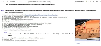

FYI, ZF has specific guidelines for fluid changes. Need to fill it, get it up to temp while going through gears, park, reverse, etc., and then top off again.
Anybody able to get their hands on a service manual pdf? not the owner's manual, an actual service manual.
Here is the procedure for the ZF .
