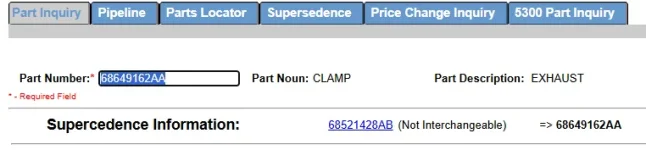

Just an update. We have been fighting a leak from one of the down pipes, where it meets up with the cat, all day. We've tried everything and have not been able to get it to seal up. I tried to reach out to AWE both via phone and email, but have not had anyone contact me back.
There are gaskets that go between the cat pipe and the rest of the exhaust. I believe we may have messed one of them up in the initial install. These gaskets are not sold separately. I believe they come with the clamp, part # 68649162AA. I have ordered some and will report back when I get them.

Yes sir. new gaskets come with the updated clamp part #. These fixed my leaks (y)
MSRP for $59.45 each
DO NOT take the gasket off the clamp when installing. These are meant to be installed as an assembly onto the pipe, and then attached to the cat.
Ask me how I figured that out. 🤦‍♂️:(o_O
