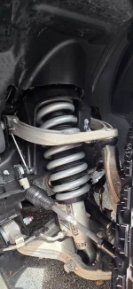

This is a picture with the 1.6" Eibachs. OEM ride height sensor. CV angle looks great too.
Have you had issues with shifting like launch controls or when flooring it from a stop because of the ride height sensors also not reading speed limit signs as well???
No issues with the 1.6" level. At all. Had them on for about 9 months now. Quick note. I took that picture the same day I got the truck back. The installer forgot to transfer the rubber grommets from the OEM springs. That picture is metal on metal. No bueno. Make sure they use the rubber grommets from the OEM springs on the Eibachs.
