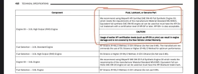

Probably better to go with the oil that has both API-SP & MS but you’ll still be within warranty if it’s only API-SP or API-SN+.

I have had great luck with Pennzoil Ultra Platinum. That is what they put in at the factory from what I have read also. The only issue is I normally buy 0w-20 that comes in 5qt jug and 0w-40 is sold by the quart so it ends up being 1/3 more expensive.
Exceeds the requirements of the following industry and OEl specifications:
  • API SP-Resource Conserving and all previous Categories
  • Chrysler MS-A0921
To find the right Pennzoil" product for your vehicles and equipment, please consult www.pennzoil.com to look up the right motor oil recommendation using our oil selector.
