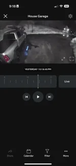

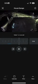

Well Murphy's Law for me. Truck has been perfect for 900 miles and today I went to go to work and the battery was dead. When I checked it the battery was at 4 volts and took a battery charger on start and a jump start pack on the aux battery to start it up. I went out around 10 last nightand changed the deafult 15 radio presets to 30 and turned comfort settings to all starts. I am 100% sure everything was off and truck locked when I went in. Another option is I have it set to use my house wifi and wonder if it got an over the air update last night that caused things to stay on. Multiple things not working on the ride into work but when I got here it did start back up but all the warnings and check engine light were still on. Have it hooked up to a charger while I am at work today.
Well thank you ring camera. The truck 100% turned itself back on and then stayed on until it killed the battery. This is a software issue for sure.

I might be now lol. So for anyone who cares I made a few changes in uconnect. I did not start the truck after the changes and then went inside. About 5 minutes later I hit the lock button on the key fob and went to bed. I never looked to see if that turned on the puddle lights and then they stayed on or if it got an update and turned them on by itself.
Is your key or keycard close to the truck? That looks like the proximity light kicked on.
No, and early in the thread I mentioned that I had a car with issues and learned from that. Also pinging the truck and keeping the computer on will not turn on the puddle lights for over 4 hours in single digit temps. I obviously have no idea what else was on but I know from the video the puddle lights were. I have a JL Wrangler and a Grand Cherokee so I know all about uconnect gremlins lol. I will be double checking all lights are off before bed and if I make any changes in uconnect I start up the truck after and shut it down.
