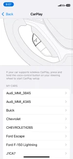

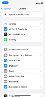

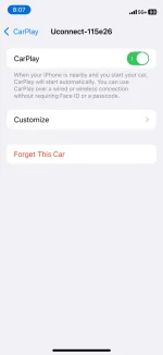

So finally got my wireless carplay to work on my iphone 12 at 1410 miles. It has always worked plugged in. So what I did(which I never done before) Iphone settings-general-carplay-then into your uconnect connection then turn on Carplay to green. Now works great.
