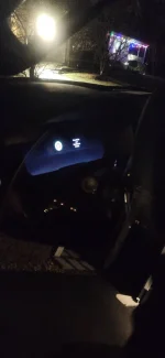

I've seen many have had the dead battery or battery drain issue. I noticed my truck had the dash still on about 30 minutes after I ha locked the truck with the key nowhere nearby. Woke up this morning to a dead truck. Does anybody have a service report from their fix or any other information that can be provided to a dealer to speed up diagnosis and repair? My local dealer (didn't buy it there) had not yet heard of this issue. I'm trying to avoid a long drawn out process.

I just had no change in about 45 mimutes. I just disconnected the main battery and still heard humming, disconnected the smaller one and the truck went silent. Going to let it sit for 30 minutes and then hook up a trickle charger until tomorrow morning and see where it's at. One thing I noticed, the only other light in the truck that is on when off and doors locked is the lane departure button(i have it turned off) on the top right of the screen. Wonder if that has any meaning.
I just woke my RHO up from slumber. I too keep lane departure off. As soon as it woke up, interior lights, dash & lane departure illuminated. I locked it & interior lights immediately faded to black, but dash & lane departure remained illuminated for 1 minute, then turned off.
I locked my truck using the handle touch square. How do you lock yours?

I've been using the key for, I'll try the door next time to see if that changes anything. The dash(speed and rpm gauge screen) and the lane departure light stay on for me, but don't turn off

After I pulled the negative battery terminal for about 30 minutes, I hooked it back up and have it on a trickle charger. Oddly enough, this time the dash turned off after a minute and there was a humming for about 5 minutes after that. Good sign. Going to start it in the morning and see if the CEL disappeared too.

Let us know what they say please! There's obviously something draining the battery, have you noticed your instrument cluster staying lit up like mine did? I feel like there has to be a certain setting or something only some people are doing that is causing this, otherwise everyone's would be doing it

Yeah same here, we'll tonight that's the case, last night the instrument cluster stayed on for at least 30 minutes, possibly longer i didn't go back out to check, all I know is this morning the battery was dead. Tonight everything was off and no noises after a few minutes. Hoping it will start right up tomorrow, i have it on a charger anyway.
