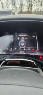

Can you share a picture of what you are seeing on voltage? Maybe a video?
I only see a static number & it’s over 14V, likely because I’ve charged my batteries several times.
Sorry, I don’t have the small battery info. It’s hidden under a holding clamp. Call the dealer. The batteries should be under warranty.
Didn't get a video, but basically would idle at 12.8volts, then when letting off the gas it would go up to 14.3 and slowly drop back down to 13 as I applied throttle
Just bought 2 new batteries, the main battery is an H7 agm, the smaller I will look up the receipt, but also an agm.
Truck is now idling at 14.5 volts! Going to keep it off the battery tender tonight and see what happens now that the app is deleted and new batteries.

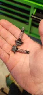

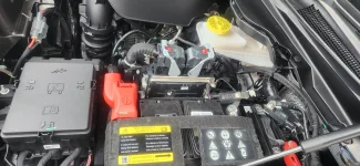

Also, found the battery tray had sitting water I'm it, picture was after i used a towel to dry it up, still a little damp and found these two bolts sitting in the battery tray
