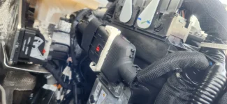

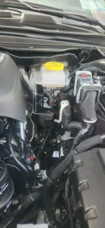

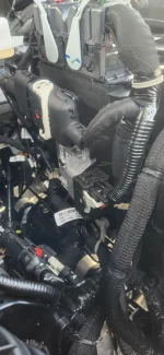

Can you take a photo of the wire harness connector in front of your brake booster? It’s blocked by the ECM in your previous photo of the battery.
Either post here or send me a private message. I need to see if yours looks similar to mine.
looking from the front of the truck you mean?

Any of these work?

What are you trying to figure put?
Trying to see where my power running board wires were run. Think I figured it out.
Somebody didn’t properly reinstall the harness connector dust cover. Knew something wasn’t right. But, it’ll get fixed.
