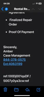

Call 1-866-726-4636 and get a case number and case manager assigned. Keep your expectations low. My case manager updates me once a week. Right now I’m over 30 days in shop and the part supplier estimates April 28th before my back ordered PDC is available. As far as concessions, I’m told that once the truck is out of the shop, they’ll reimburse the payments made while the truck was in for service. Here’s a little trick I found to get around dialing into the cubicle farm so you can create a paper record of your case. At first, the case manager refused to provide a direct line or e-mail but then I asked how do I get reimbursed for my rental car. (My dealer does have me driving around like a Jabroni in a loaner V-6 charger) Then came the e-mail with a direct line and her extension. If anyone has better advice or something to the contrary, let me know.

Your new truck has been in service for over a month? Does your state have lemon laws? Did RAM CARE reimburse your monthly payment, insurance and rental? I would be hard pressed not to tell them to keep the truck and give me money back.
