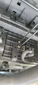

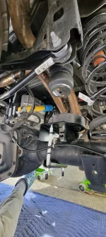

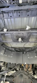

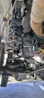

Finally completed the install -- after the box was sitting in my garage over a month waiting on my schedule and weather to cooperate! These photos were right before I made a final adjustment to the passenger side cradle and set air to 15psi. The install --- well, it would've been easier if I didn't have to pull the passenger side exhaust off -- there was just no way to get the kit installed while the pipe was bolted up....notice the heat shield they provide, there's also heat shield provided for the air line. Other than that, it was pretty straight forward. My low profile floor jacks were able to get the truck plenty high enough to bolt it all up. I'm ready to tow!
