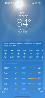

Off by 1 degree
Not sure how accurate the app is but I’m happy with it.
Nice 👍
