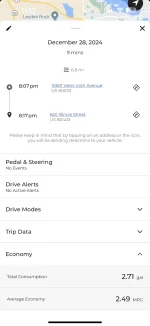

I just checked the app, shows my recent trips and shows average MPG.. on the last drive I just did 6.8 miles the app shows 2.49 MPG??? 2.71 gallons consumed in 6.8 miles????? On the truck dashboard it said something like 12 mpg.. I was feathering the throttle, never even gave more than 10% throttle yet. App has to be way off.

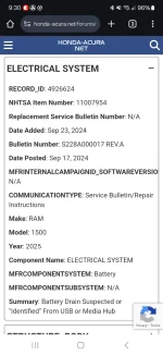

With these random battery issues popping up all over the place, I'm wondering if that module behind the uconnect display is causing everyone's issues. Sounds like a bad batch of them may have come thru the factory. I know one person received a service warning for uconnect and could be related to that module as well. That module controls a large portion of the systems in the truck and seems like a possible culprit. I can't remember the actual acronym for the module, but BCM keeps coming to mind. I also found a service advisory for the USB media hub causing power drain. Screenshot attached.

Does anyone have the wiring schematic to show what fuse controls power to the usb media module? If we could narrow that down then could be a possible try to pull it and see if the power drain stops happening.
