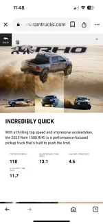

I mean on the website top speed it’s advised as 118… false advertising? Not the anyone would probably but can’t you sue for misrepresentation or deception? What if you bought it specifically for drag racing on a endless runway but can’t go over 98mph 😂

Where are they advertising 118 mph top speed in sales brochure material? Do you have a link (I’m not referring to press releases, I’m referring to official sales brochure/order guide material that a customer would use to decide on a purchase). I’m just trying to figure out what would make the average person think that Ram has to provide a vehicle with a certain top speed.
I have seen the 118 somewhere, but I can no longer find it. I do see 0-100 time. 98 is close to 100, but not 100. lol
