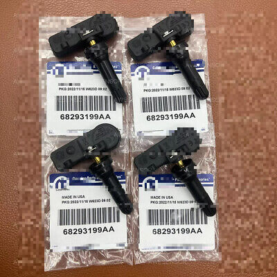

These are what i got: from Moparonlineparts.com
Part Number
68293199AA
Tire Pressure Sensor
$39.10 x 4
