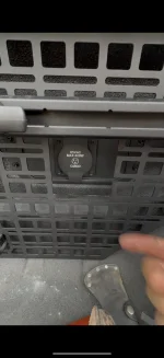

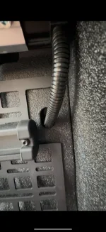

Finally installed the MOLLE panels from Amazon. Had to borrow an angle grinder from work to cut out the power outlet area and areas at the bulkhead so that my drain tubes for tonneau cover would fit. Zero instructions you just have to figure out what hardware you need for your application. Installing the utility rails back on and aligning with the MOLLE panel holes was kind of difficult with just myself. Grinded/polished and painted the cuts I made and it turned out pretty well.
If anyone has recommendations on what attachment methods are best to use with these panels that would be awesome. First time using them and I was really confused with the Velcro and straps that came with the kit.

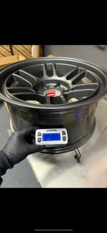

man those have got to weigh 112-115 lbs a corner.
Here's the breakdown:
OEM 325/65r18 tire weight 64lbs
OEM beadlock capable wheel weight 42lbs
Nitto Ridgegrap 37x13.50R18 weight 89lbs
Enkei RPT1 wheel 18x9 weight 23lbs
Net gain of only 6lbs per corner over the OEM assembly.

Did you weigh those wheels? because that's lighter than 17x9 RPT1's. Just curious if they are really that light.

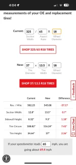

@Adub Did you recalibrate the speedo for the bigger tire?
If not, probably knock off about 2 mpg’s for the 37’s.
Unable until Tazer gets the unlock for us. Good point though. I’ll need to start hand calculating for accuracy.
