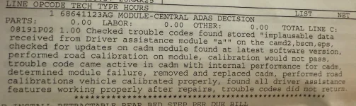

Which module did they replace? The central adas module?
Just got a call from dealer and they haven’t found anything, but they opened a case with RAM to see what they say tomorrow. Hopefully they tell them what to replace.
This is from the paperwork I got back. Maybe it will help your dealership out
From AI:
“The "CADM module" refers to the Central ADAS Decision Module, a critical component in modern vehicle Advanced Driver-Assistance Systems (ADAS) that makes decisions about lane centering and other functions.”
