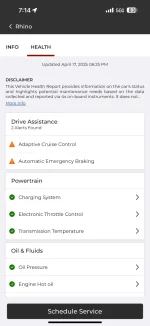

Well, add me to this illustrious list of owners with issues regarding ACC and AEB problems. Looked down this evening while driving and the AEB OFF light was illuminated. Got to a parking lot and went into the UConnect screen and tried to play with the settings to see what would happen. Here’s a video. The truck would not let me change settings, and it kept reverting back to the old settings as shown.
Yea that is what happened to most of us. Hopefully it went away after letting the car sit.
I was hoping the same, but the light was still on this morning after sitting all night. :(:(
Update on my AEB warning light... Easter miracle occurred and while driving yesterday, I went into the U Connect screen and checked the status again. The AEB was switched to the "off" position, but I was able to select "ON" and the light went away. All is well for now. Service visit avoided for now. Thank GOD.
Unfortunately mine does the same, but comes back a day or two later even after you’re able to select “ON” and light goes away. Mines getting dropped off Wednesday.
Yeah, I'm fully expecting it to pop back on sooner than later. Please keep me posted on what they find with yours once you know something. I'd greatly appreciate it. Good Luck!
