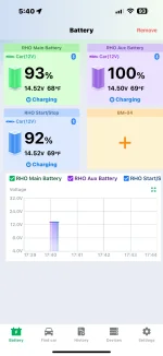

I have gone off the deep end with all this battery stuff.
1. Replaced main battery
2. Replaced start/stop battery
3. Installed the OEM battery in bed of truck with an isolator switch (lets the charge come from alternator but not back to main battery)
4. All aftermarket accessories tied to Aux Bed Battery - Electric steps, electric bed cover and dual ARB air compressor
5. Install (3) Bluetooth battery monitors
6. Installed NOCO 5x2 battery charger under the hood and it keeps all 3 batteries charged as does the alternator.
A plus to this setup is that in the event your main battery dies there happens to be a spare battery in the bed!

I wanted to isolate EVERYTHING aftermarket from the Ram computer. I also carry around a NOCO jump pack and have considered sticking a Jackery in the mix or a inverter to run the on board NOCO charger.

I was having substantial voltage drop even with replacement batteries for a couple months until recently. I left my truck sitting for 3 days with keys/card put away in a faraday box and my battery monitors only went down to 73% SOC (state of charge) and 12.8 volts. Previously it would drop to around 63% at 12.2 volts in the same amount of time. I wish there was a way to know if or when there was an OTA update. I just have a hard time letting my brand new truck just sit for a week or two to do more test.
