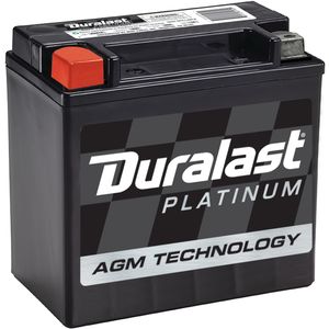

Had the same issue, just took them in and they sized them up, performance on these is actually rated better than the stock Mopar batteries. For the smaller battery you need an etorx socket to remove the studs from the old battery. Here are the two sizes:
