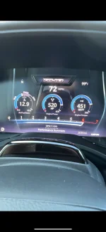

As promised here is a video and photo.
I’m curious what my G-TECH would show.
So it hit 510 HP on the dash, what HP was on uconnect screen?
This was my result, clearly the two interfaces report differently. RAM Engineering 🤣

Ok…truck back from service…Ram acknowledges the 400 HP peak on the Performance Pages…per Ram, the truck “runs fine”, so keep driving it. Advisor stated it may or may not be producing the advertised HP. They don’t know.
The latest “misfires” software update is the likely culprit. No fix at this time. Maybe in a future release.
Hmmm. It was hot here yesterday & I couldn’t get the HP meter near 400 HP. I expect lower power in extreme heat. So, it appears the gage does more than read RPM & throttle position. It obviously uses a more complex algorithm of input parameters.

Dang. 540hp confirmed this morning. Hopefully you get sorted out soon brother
Having come from a Hemi with about 400hp to the RHO with 540hp… the difference is substantial. I just can’t imagine something so drastic changed and you wouldn’t immediately feel it. I’m 100% convinced this is purely software related.

I confirmed this morning that my dash HP gauge also reads 500+. Uconnect screen shows different. I'm with you guys. Has to be a glitch. Truck feels fine. On a side note, as anyone noticed while using Launch control in baja mode, the 1-2 shift is a bit harsh with no "fart burble" when shifting? Just curious.
Just tested mine. Highest dash reading I got was 446 with multiple pulls. Info screen the max power was like 340 and it’s set to HP. I swear when I got the truck I saw it read over 540 on the dash

Does anyone know if the truck pulls power based on ambient outside temp that is obviously very incorrect? I’m guessing that’s not the case but I am concerned that even on the dash i’m 100hp short of 540. And on center screen I’m maybe 320 max at wot.

It got up to 94 today. Started it let it warm up then ripped it multiple times trying to get hp on dash to go to what others have seen around 540. Not close and all temp gauges were completely fine. I don’t understand.
