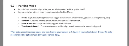

I got the Compustar T13 PRO RFX with Drone XC1 front dashcam and RC1 rear cam. Got a blue LED over my driver side vent when it's armed. Hopefully that'll be enough of a deterrent. Have some organized crime problem around here, stealing and exporting vehicles. At least the IGLA helped keep it safe. But, the clean-up after the break-in has been a big pain.
Shitty thing is, the battery gets drained down pretty quickly with the new alarm. Which is odd, cause the camera doesn't do much unless you put it in live-mode. Also having 2 fobs and pulling the fob outta pocket to unlock/lock the vehicle. Apparently, this system has a proximity unlock feature that can be enabled to avoid that. Not sure if the system dealer left that off to avoid having the security fob cloned.

The drone xc is just garbage and I actually refuse to even advertise it. Adding a live camera and even the tracking will drain the battery especially if you have the XC parking mode on. Will kill the battery in a day or two if its on. IGLA and compustar isn’t the drain, its the XC and its settings.

T13 is a remote kit added to a module, in your case it would be the new DCX. Its not going to drain the battery if you keep the drone XC dashcam out of the equation. It will naturally have a small drain like anything else added to a vehicle and like all modern vehicles if one doesn’t plan on driving it for 5+ day or more simply keep it on a maintainer or solar charger if its outside away from a plug in. I use them all the time. 2 minutes to plug it in will save you a lot of hassle

I get the alerts on my phone at least for starts and locks and shit I guess. They sold it to me as it chirping when someone approached the vehicle. Hoping that it would be a deterrent to someone busting out my window again. But, it's just the dashcam that makes a noise. And, not much noise gets out of the RHO.

You have parking mode on which says in the manual if you don’t drive it every day to turn it off because on day 2 your vehicle will be dead. Its a shit product that was under engineered and not even close to enough testing.

Its on page 17 of the user manual. Its “too large” for me to post
