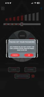

My truck sat an hour with door open with key in my faraday bag and still threw multiple faults. I unhooked both batteries completely for an hour and plugged roar back in. After connecting both batteries all messages were gone. Is the learn just pedal normal and then pedal full down? Does anyone else have a problem trusting a company that can’t spell?

Dude just follow the instructions...
"LOOSEN ACCEL ERATOR PEDEL AND CLCIK OK"
That's so bad lol. I've heard their customer service sucks, too. Knock on wood though, the product has worked perfectly for me. I'd love to go with a real company like Banks, but they haven't made one for it yet. Hopefully they will soon. Roar Pedal is just some guy in Maryland buying overseas chips and selling them. Their "address" is literally an apartment IIRC lol.

Yes, just click learn, don't touch pedal and set the first one...then press all the way to floor and set the second one.

I figured loosen meant don’t touch. The instructions said four digits and I had three on the phone app and second code gave me four after the pedal full down. I was going to take the pedel off before clciking next button. My daughter is in third grade so obviously the people running this company didn’t greguate the third grade.
Yeah, I want to say the first setting for me was like 426, and the second was 5k something...yours sounds correct though.
