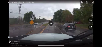

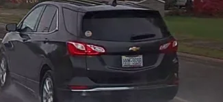

Fitcam uses old sensor, it's not even real 4K, it's oversampled to 4K from like 2.7K, that's why the footage is pretty bad, especially when you want to read license plates. Look for a dashcam that uses Sony Starvis 2 sensor.
Just sharing, I can’t compare the cameras, I’ve only had the FitcamX. It’s hardwired, with rear and I’ve been happy with it. Here is a screenshot of a recording, in the rain, and can read the plate. Two pictures, the zoom is of the first picture to judge distance. Again, make your own decisions on what’s right. I went with FitcamX for OEM look. Note, hardwired with park mode has not impacted my battery. Hope this helps.

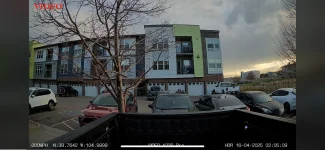

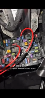

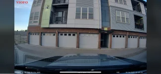

This is from my install of VIOFO A229 pro. Wires are just seen going up into the headliner. Video here (excuse my caption lol) kind of showing the routing to hardwire it. Screenshotted a pic to show fuses I tapped into. One was for passenger wireless charger (which I don’t even have) and the other was for passenger heated seat module. Works perfectly. Hope this helps those wanting to hardwire.
