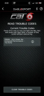

Just installed the cat6 on my rho. Went to turn it on and now it’s got a check engine light. Any help?
Same thing happened to me. Try two things.
First, use the app to read the codes and clear them. If that doesn’t do the trick…
It might be the result of reconnecting the batteries in the wrong sequence. Try disconnecting the negative cables on both batteries, then reconnect the auxiliary (small one) first, then the second battery.

Let me try that. It threw this code at me.

Yep. That’s the code I got too. There’s another thread on the forum that covers this in more detail, but that seems to be a common code and issue the battery reconnection can help.

Okay, Disconnected both batteries ( negative ) and the reconnected the auxiliary battery first then main battery. Check engine light was still there, went into the app and cleared it. Now it’s gone. I don’t think it should give me any trouble? Thanks for your help!!!

Awesome! Happy to help.

I had this same exact code upon installation as well. Cleared it with the app (didn't bother with battery re-connection) and it never came back. You should be good 👍🏼
