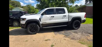

Well ended up buying some 20x10 -19 offset , but dont like the big center cap so bought some fuel flames 20x9s
View attachment 29488View attachment 29489View attachment 29490View attachment 29491View attachment 29492
Happy with how this turned out... typically default to 37s on 18s but really did not want to add rotating weight here and lose any accel or MPG. Previous truck was a 23 Powerwagon on 38s getting 10-11mpg and 0-60 in a couple business days lol... 325/60R20 is nearly an inch taller than stock but the Mickey Thompson Open 5, 20x9, zero offset wheels are light so ended up nearly identical weight as stock setup. Plan to trim the rear spring a little (1/2 coil off the top should drop the rear ~1") to get a reverse level with a little rake left...
I just got mine on today. Only difference is I did 37s the Micky Thompson, Baja EXP. Quick question the center caps didn’t pop in on the front because of the axle sticking out. What did you do for center cap in the front?

Definitely feels heavier but not as bad as I thought , it’s definitely not shifting into eighth gear as much on the lower speeds around 55 to 65. I got these wheels because they were light and the tires were only 68 pounds apiece so I shouldn’t have increased rotating mass too much.

Looks amazing! Considering 37s but really don't want to reduce MPG and add rotating mass... but seeing that makes me think the usual...F it, order em lol
And yes that's the one part that sucks... had to shave that axle end down a touch to get the caps on. Considered painting it but really wanted a cleaner look.
Take a look at these Baja expos on 68 lbs for 37s not bad.
Did you use a grinder to cut it down ?
