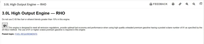

Owners manual states 91 octane and no Ethanol greater than 15%

I know what the owners manual says, but like mentioned previously here in Alaska we only have up to 90 octane fuel.
I would like to get an RHO but want to know how it will run on 90 or if that will damage anything in the long run.

It’s 91 at sea level. Higher elevations can use lower octane. Even at sea level you can use lower octane and knock sensors will pull timing to protect but don’t expect rated power outputs.

that's the funny thing even here in Alaska where i am I close to sea level I know the truck is still very new, I am just curious how much power/performance i would loose over 1 octane rating on the fuel. or even running it at 87, if it is significant enough i may just go with a rebel GT.

Copy That .. IMO it would be fine but only time would tell on long term reliability. I would think there is bit of room in this specification and engine programming as stated in the engineering video. Plenty of AV gas in Alaska, maybe drop a gallon in every fill up to increase on octane a bit. Seem like this would be a perfect Alaska truck.

Ram Engineer told me you can run 87 Octane but would not allow me to put it on a YT video as he didnt want to be held responsible for the info. He said its like the 3.5EB HO from Ford that you should run 91+ octane but you can run 87 octane it just retards timing. Should be ok for winter use, highway driving, but if pushing it towing or off road use probably should only run 91+

To be fair, this thread was started because 91+ octane isn't available in AK, not over fuel cost. The Edmunds article and RAM engineer comments at SEMA quoted earlier in this thread, seem to be as close to 'official' authorization to use < 91 octane fuel that's been made public. However, for warranty concerns of RHOs operated in AK, the answer for the minimum acceptable octane will likely need to come from a dealership or RAM HQ.
